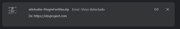

This latest update won't let me download, as it's giving me a virus threat. I hope you can fix this problem.
